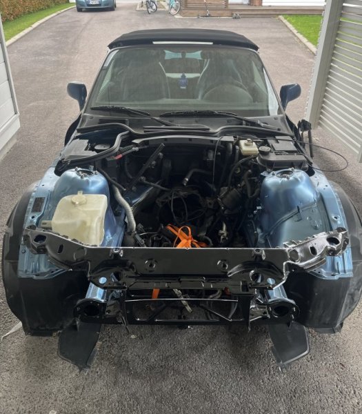

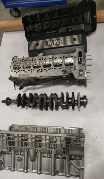

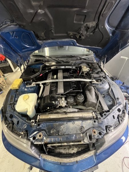

Update on this project;

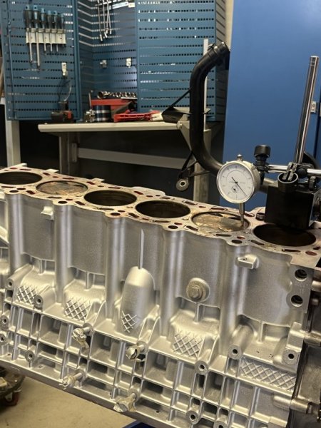

New 2,8litre engine has been fitted

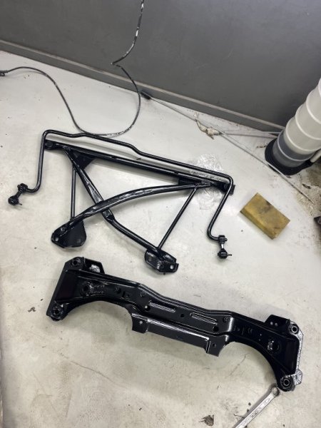

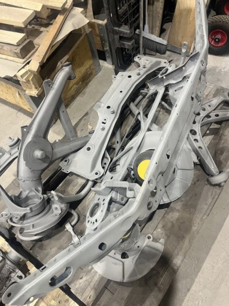

Bottom of car,chassis etc has been blasted and painted
I have trial installed the kit and the fitment is not best and in some places it will require strengthening because the fibreglass is very thin in some places. I will also trial install the stainless grill, bumpers etc before I start working with the car but I see a lot of work infront of me during the winter.
I guess most work will be with the trunk and door gaps.

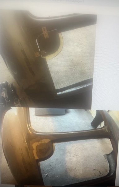

I see there is a big cap between the kit and original z3 body behind the rear window. Should it be like this or is the body not installed correctly?
How have you closed the gap inside the trunk between the kit and original z3 trunk?It’s like a 5cm gap 😁
  • Like
Reactions: mittaw
Z3 project
I don't know about that kit, but I would say get the roof out so you can see better where everything is supposed to line up/ fit against.
The roof just gets in the way at present.
I got everything out of the way and kept adjusting the GRP until everything fitted (or didn't fit) by the same amounts. Generally the door skins are the best place to take datums from, as the skins can't move much, nor can the Z3 doors.
You have a lovely, big tidy space to work in, though. :thumbsup:
Mine is 507-ish body kit and I must have had my rear section on and off 20 (or more) times. Couldn't figure out the gap across the top (where your hand is) then one day i had a toolbox under the bumper supporting the very back end and that top edge just settled down. Lifting the very back up slightly allowed that front edge to settle down. At that moment I glued and bolted it all in place.
The sides above the inner wheel arches. Yes. I have that gap too. I wonder if I should have kept a small section of the old steel wings but they're long gone. My plan now is to close it off with GRP sheet.

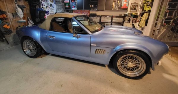

I trial installed the front lights, Grassbank bumpers, cowl and the rear bumper. Need to align them a bit better before installing them
Those bumpers look fantastic. I'm not sure they look right on the coupe but on the convertable thet look stunning and do on yours!
Is it the photo, or is the bonnet (hood) 'scoop'/ cowl not sitting straight? It looks to be pointing toward the front left.

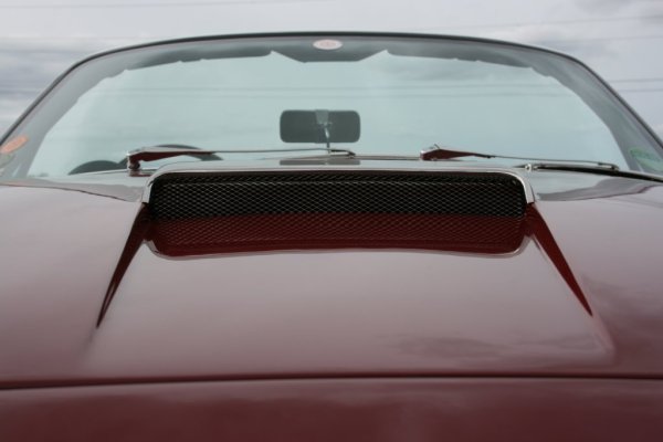

Does anyone know if there is a chrome scoop frame available somewhere?
I've not been able to find a scoop frame but im making one from a length of aluminium bent under heat using a wooden template.
Z3 project
I got one with my kit, but don't know who makes them. Although my scoop may be a different size.
If you know a stainless steel fabricator they could make one easily if you give them a template. They are only a bent 'L' section of 306 grade stainless.
Mine didn't fit very well (there's a surprise), so I had to manipulate and grind it a bit, but as it is very thin it was easy to 're-bend'. I spent many hours sanding and shaping the GRP so the trim would fit snugly aswell.
The trim details are one of the most important parts of building a car IMO, as these are the bits that you see all the time. They can make the difference between it looking like an 'average' home-built kit car and something special. In my humble opinion.
