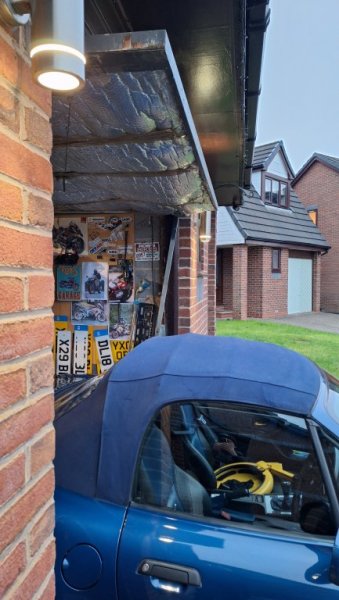

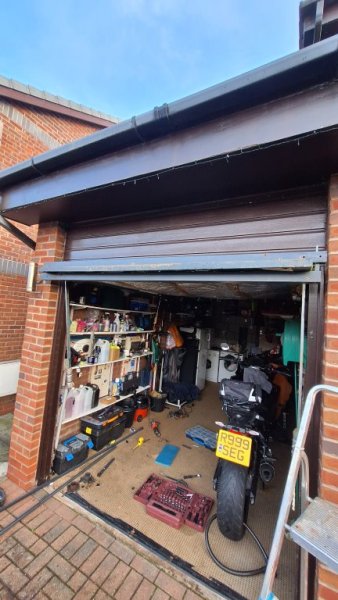

Seen all these hoists but I can't mount 1 on the garage ceiling, It'll need to be a free standing affair or, a removable system i can loop over the open garage door above my head.(bottom of the door) Id be able to back the car up and get the roof under door if you get me.

Think I may have come up with an idea, just need to do a bit of cutting and drilling.
Im going for the garage door as a lifting point.

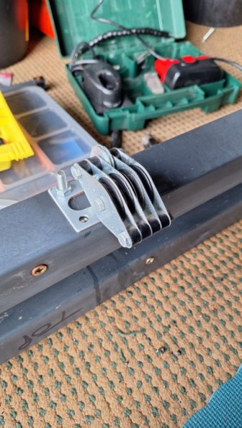

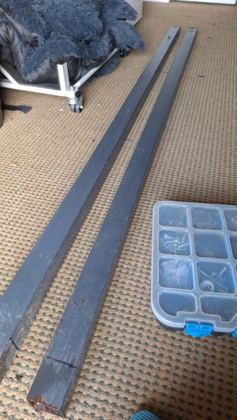

Anyway, on with the building process. Fits over garage door nicely, Just need 2 straps and I'll be having a go at a slow lift.

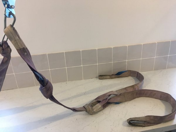

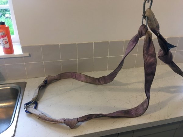

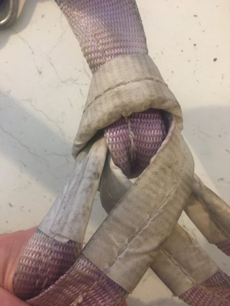

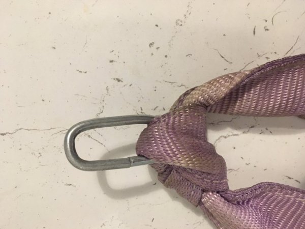

To lift the hardtop horizontally: Get 5 webbing slings and 4 carabiners. Form a ‘Y’ with 3 of slings. This is for lifting at the back of the hardtop, behind the window. Hook the loops at the end of the slings around the spikes on the hardtop.
The other two slings pass through the car, to be connected by carabiners.
Connect all slings together above the roof, as shown in this pic.

Thanks for the image and write up..
I'm waiting on the straps to see how i go, ideally as yours i need to be as far back as can as a lifting point due to restrictions on the working area.

These 2 pass through the car, to be connected inside the car by a carabiner.
Also shown how all slings are connected together above the car (sorry for multiple posts, but don’t know how to post & comment on more than one pic at a time.,.)

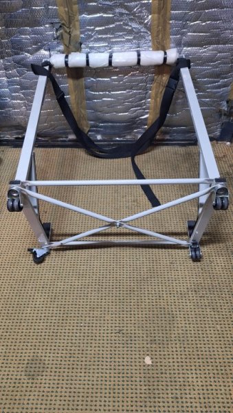

Going to take off the roof and lay it on the ground then configure the straps. Only need to lift a few inches to see how it'll react. No dramas then.
If it works, again I only need lift it clear of the spikes to the bodywork, move the car then lower on to the trolley.
The weight baring frame over the garage doors is from the legs of an old Gazebo i've been meaning to tip but been too long for the car boot.
Plenty of dog blankets on the drive and should be ok !🤞

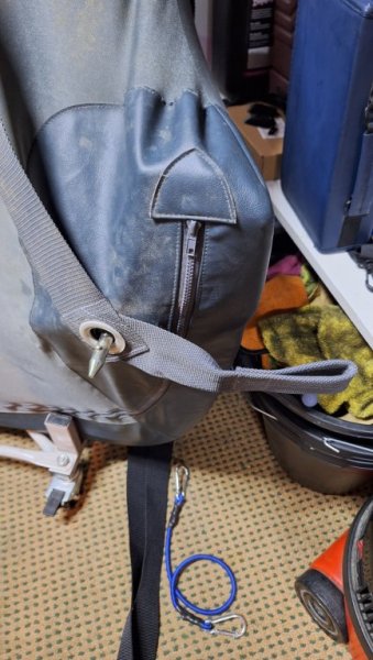

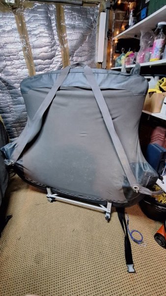

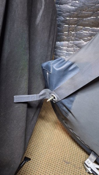

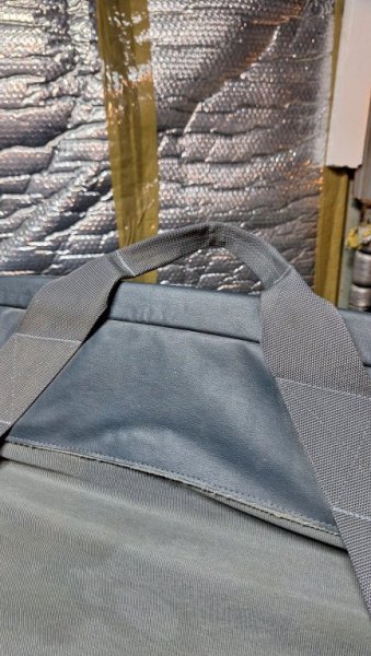

Took the roof off in preparation for trying out the lift.
Decided to put it away in the bag it came with which ive never used.. funny to find 3 ideally placed handles that the hoist could link into dead easy, sussed ...
However the drama, and I think it would be, would be getting the cover on the roof whilst it's still sat on the car, seems a huge faff but I'll consider it for the ongoing project.
