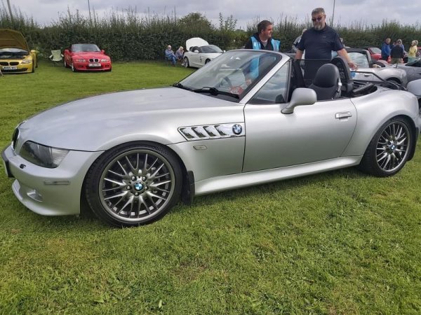

I have mudflaps on my coupe.
No issues with rust - in fact when I had a lot of bodywork done on my car a couple of years back, the mudflap ends of the side skirts were clean and fairly rust free.
I have genuine BMW flaps - though they are NLA - so you need to source a used set from a breaker.
