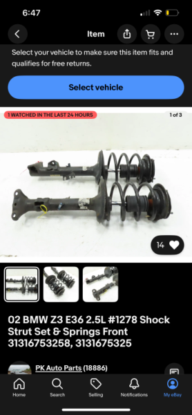

Probably gonna order these now any thoughts on if I should change the springs and if so any reccomendations it’s from a 6 cyl model

I haven’t actually seen one of those in the us before but I went ahead and ordered some stock front shock and springs from a 6 cylinder e36 should also be way better because my current front suspension is for a 4 cyl so the weight from the v8 is definitely a bit much for it and got the reinforcements so I’ll post an update on how it fixes the sag when it gets here

My biggest issue was just only finding the fronts, ended up going with what he mentioned and found oem front shock from a 6 cyl e36 (super happy with the rear ride height genuinely just concerned by the sag in the front from a height perspective

Update got used e36 6 cylinder shocks and it fixed the sag and ride quality entirely
if anyone else ends up with a v8 swap on a 4 cylinder model I highly recommend the 6 cylinder e36 shocks if you just want a budget oem setup
