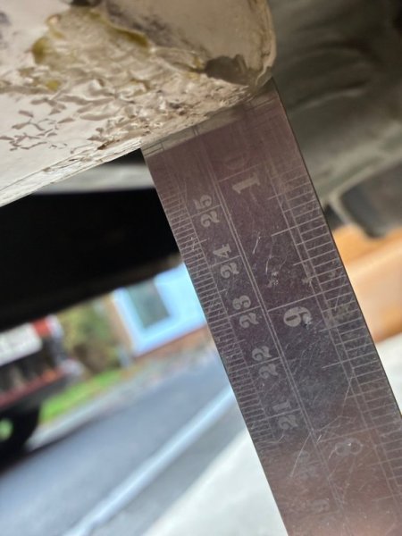

I have 17" wheels and 245/40 tyres, giving an effective diameter of 24".
As you can see from the pictures the ground clearance at the rear of the wheel arch is about 265mm and the lip height at the boot is 500mm.
Is this the same for anybody else?
What are you saying? Your car is sitting too high?

Hello Pond
What I'm asking is: If your car has the same rear wheel size and you are happy with the ride height, are the measurements at the bottom of the rear wing and the boot aperture, the same as mine; 265mm and 500mm?
I still don't see how pushing the body down at the back will solve the windscreen issue, particularly if the ride height at the back is about right.

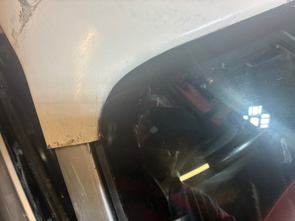

Once the rear boot shelf is in place and the coupe body on its easy to see where the door edges line up as the coupe shell bolts to the existing bolt holes. Once you have the boot shelf in place and thr bolt holes lined up (some may need extending a little) you have it all set up correct. Its just on mine the window sat too far forward. Wheneve i pushed the window wdge back the alignment with thw bootshelf and bolts were off...hense i cut the window edge back. Id be interested to see what chris says but this worked for me anyhow.

I have measured the distance between the rear lights as roughly 1080mm, which is roughly double the 500mm height of my boot lip. If I look at any rear view pictures of finished cars, it looks like the boot lip is lower that half the distance between the rear lights. I'm thinking Chris from Tribute is correct, in that the back panel needs to go down. Given the position of the parcel shelf, boot extension, and B pillar (still the B pillar - even though there is only half of it). I'm not clear how it is going to happen.

The panel sits so beautifully in the wrong place. I'm convinced the Tribute kit was designed like this.
I have decided to go the mittaw route. If the rear of the body panel could possibly go down far enough to solve the windscreen issue, there would be other problems, not least, with the exhaust pipes.
I have cut the panel to clear the windscreen seal and I'm now thinking of trhe best way to get the shape back on the edge.
Once I get this done, I'll crack on in the new year.

Hi Dave, merry christmas to you. Please let me know if you need any help or photos. Im off tge car for a few weeks but if I can get you anything when back up let me know. Ive spent a lot of time on the roof profile. Ive managed to get to a good place with it noting its fibreglass and will always flex to a degree. It could always do with more but you have to stop somewhere.
I'm glad ive done this route as my windscreen has cracked and i need a replacement which is easy with the roof like this.
Good luck, its worth the pain
