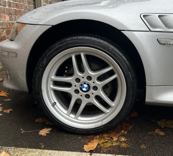

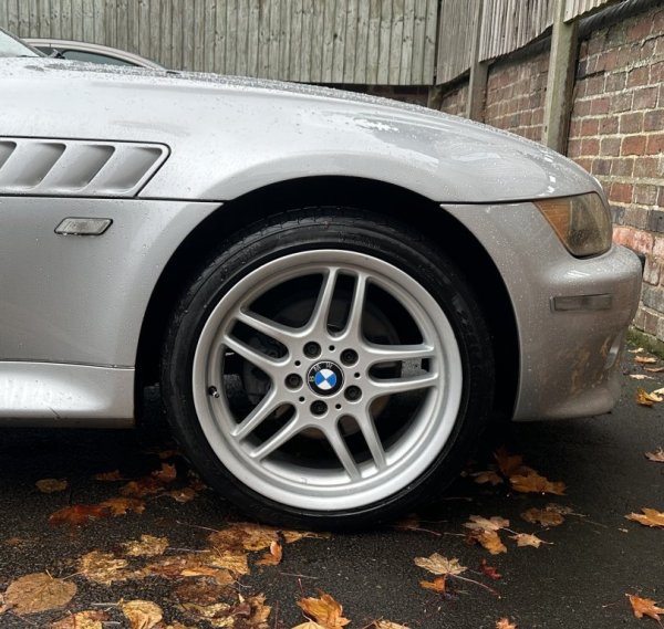

Uneven front suspension. Off side/drivers uk side was lower than near side. Was causing an issue as was so low. Took to garage. They were baffled as to why but replaced both sides front springs and shocks.
pics show results! Now both much higher but same problem persists. Near side still much higher. It looks ridiculous really. Garage says drive it to settle them but can’t see how that will even it out. They are happy to have it back in but they do not know what the issue is.
What do people think?

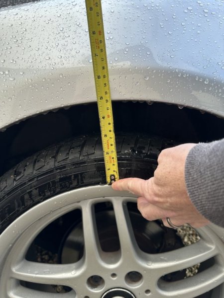

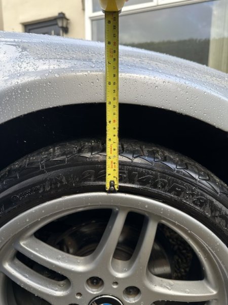

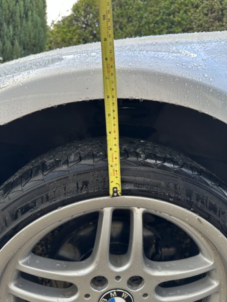

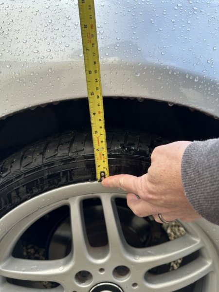

Okay. All measured. Photos attached but noted dimensions below also. Pics not in list order.
OSF 125mm
NSF 150mm
OSR 118mm
NSR 121mm
Garage are having it back on Monday. They don’t know what the issue is?!
Z3 project
OSF 125mm
OSN 150mm
OSR 118mm
OSR 121mm
I think (think!) you mean nearside front 150mm, offside front 125mm, offside rear 121mm and nearside rear 118mm.???
I would have expected the nearside rear to be much lower, given that the opposite front is sitting so high.
Zeddy28
Jan 16, 2022
19
Yes, I’ve edited now. Thanks and apologies.
The OSR is 118, NSR is 121
OSF is 125, NSF is 150.
