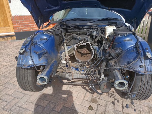

I'd never removed a Z3 engine before so it was a bit of trial and error
overall it wasn't too troublesome pretty straight forward

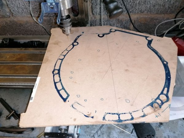

So for the adapter plate to mate the BMW bellhousing to the Nissan leaf reduction gearbox/diff housing I am using a 400mm x 400mm 12mm thick 5083 ally plate a decent hardness and good corrosion resistance
the template I have made from 6mm mdf board. First of all I made up some transfer punches on the lathe to the exact size of the holes in the bellhousing to ensure that I got the exact locations
then painted the face of the bellhousing to give me a nice outline and clamped the board to the bellhousing
I then used the custom made punches to mark the board, the gearbox input shaft location was calculated from some of these bolt holes.
I then mapped the locations of the locations of the leaf reduction gearbox/diff housing bolt holes and output shaft using a camera attached to my CNC mill
I then marked the gearbox vertical on the template and clamped it to my mill aligned the gearbox and motor shaft and vertical orientation and drilled the holes that I mapped earlier and there you have it a hopefully accurate template
