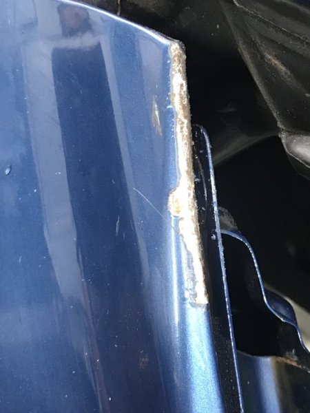

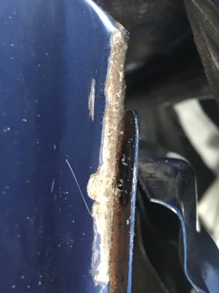

Bit of keyhole surgery to the rust on the tops of the doors. Better do it while all the windows are out. Dremel and a small file to remove the rust. And added a ‘ Steel Filler’.
Let it harden overnight.
After cleaning off the rust, this one had a small hole :arghh:….. but filler fixed it !!

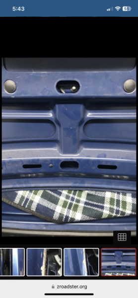

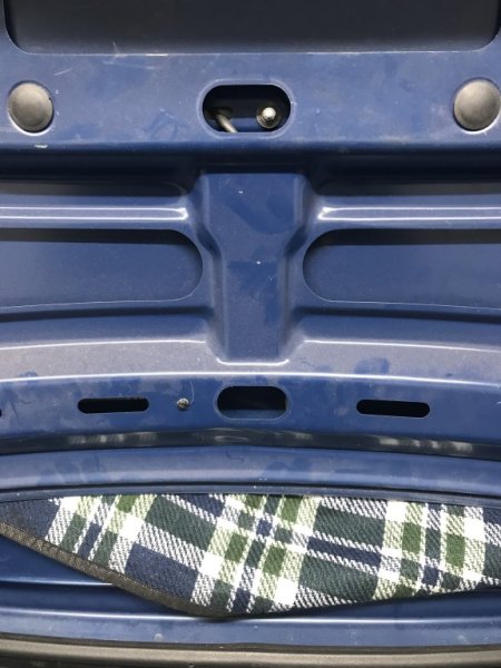

Then on to the boot….
, Got the wiring back in place and connected up. Then all the covers put back.
used a bit of earth wire to pull them
Two holes like this ….they should have something in them:whistle:
these fit ….but they were sparefrom the bonnet parts
I’ll check the RealOem to see if its the same part number.
other than that only one screw missing so not bad and I’m sure I will find one somewhere.
