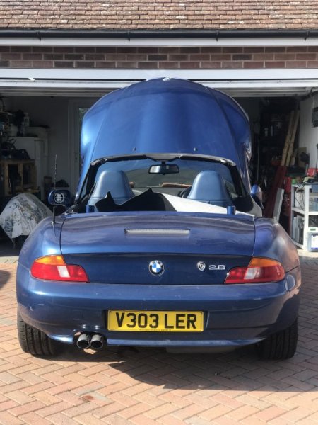

Another sunny day down in Bognor so decided to at least do something today…
Battery was a bit flat so put it on charge for an hour , and it started first time … lovely sound and no nasty noises :)
So drove the car out of the garage and turned it round …. furthest it’s gone for about 4 years =))=)),
The dash looked like a christmas tree with nearly every light on … so out with my reader and after a bit of time found how to clear all the codes …. Where’s Paul Gunter when you need him:whistle:
When the car was restarted …. this was the result…
All the Engine Management ones have cleared and only the handbrake and the three lights to do with the ABS we’re on . Which I expected as seats are not bolted down or plugged in.
So all looking positive :thumbsup:
Put the car back in the garage and put the charger back on
the orange ball stops me hitting the garage wall =))=))
This way round gives me more light and space to sort the roof.
