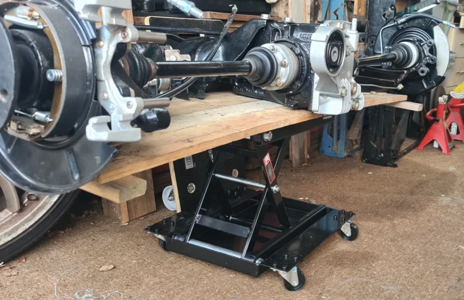

However... I did do something useful.. I recently bought a motorbike jack, as I thought it would be far easier than my current solution.
Then it was a case of transferring it from my wheelie table using a combination of lifting and two jacks
Got it high enough to slide the table jack under and Robert is your father's brother....
If I can get an impact wrench on the turning screw (think it's about a 22mm socket), then lifting it should be a doddle... *cough*

Another 6 hours in the hoist..... but... the subframe is in!

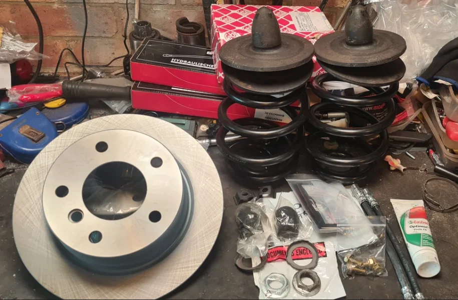

first was to gather my war chest of parts I was going to need for the day..
tried out the motorbike lift... and.... it was worth it's weight in gold.... I thoroughly recommend getting one if you're about to embark on a rear end refresh
having a coffee while assembling the hoses and brake lines... very civilised being able to do it on a stool..

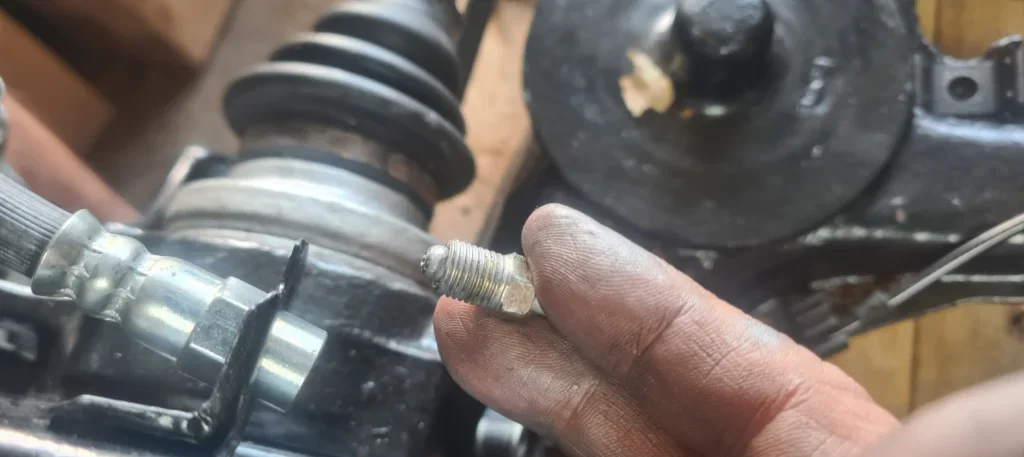

Then I hit my first gremlin... one of the brake flares was too shallow and even tightened fully was rattling in the union
but fear not, thanks to the hand held brake flare tool, redoing it was a doddle
There, much better !!

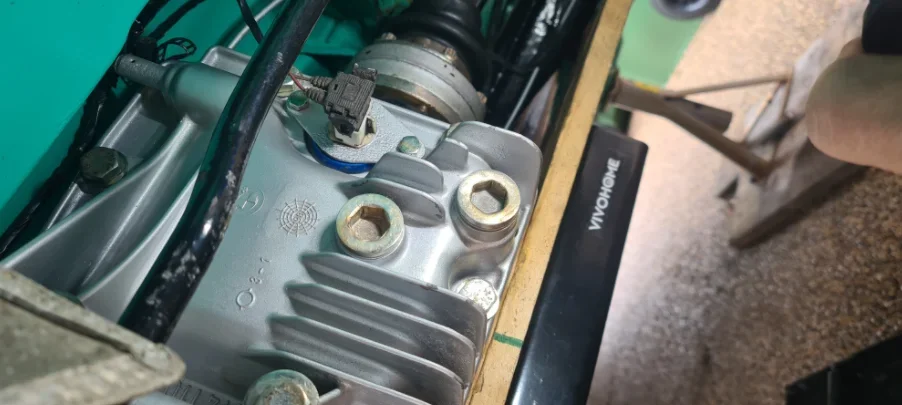

Had to tidy up that speed sensor with a hit of Hammerite Silver and zinced bolts...too much?... no ?
It was fitting it made me realise something wasn't quite right...
If you look at the washer on the long Diff bolt. It looks to big
Then I looked at the Diff bush bolt and realised I had no washers on it !!
ooops !... I'd put the Diff bolt washers the on the cover.... :whistle:
I realised I had two thin ones left over, and THESE are the ones for the cover bolt !
Soon rectified by taking the Diff bush bolt back out and putting the right washers on the right bolt !!... There... that's much better ! :whistle:
