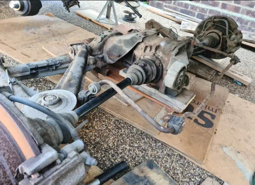

well.... today was the day.... took off the heatshield and I must have had the gods looking down on me.. none of them snapped
so the new exhaust I had fitted a few years back came with a O2 sensor that was clearly not made for my car !.. it was swinging in the breeze !
underside is very tidy I must say
dodgy sill I need to attack with Bilt Hamber @DrWong !
I think the pipes are original as when I scraped off the black paint... the pipes were clean copper underneath
driveshafts are still very decent !
Needed "The Persuader" for the Propshaft bolts
Crimped, then cut the brake lines... fixings weren't having it
Slightly precarious but it worked ....complete with my Parkside Nugga !!
aaaaaaand.... wallop.... subrame out
Used the Anti Roll Bar as a handle !!
dragged it on planks into the garage
so now starts the strip down.. underside of the car is remarkably clean... ends of the sills need a few sessions of Bilt Hamber but nothing really on the body that worries me at the moment

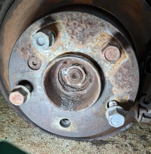

So after yesterday's euphoric progress, today I hit my first hurdle.... was intending just clearing up from yesterday, and the driveshafts were just staring at me.... "undooooo meeeee...undooooo meeeee".... so I did..... Torx bolts came out simple enough (I'd already bought the correct socket).... then thought I'd use the nugga on the wheel nut, accidentally picked the wrong socket (32mm) and rounded it off... tried a 30mm and a breaker bar but no dice......guess I could try drilling into the side of it to weaken it maybe

Is your socket 6 or 12 point? Looking at the nut a Six point should work on it ?

Hi Malc.... the 32mm was 12 point and I have a 30mm 12 point and one 6 point... tried both... tried the 6 point with a breaker bar..it catches, then pings off.. might try it with a nugga...the nut is shot anyway... if that fails I might need to drill into it.... cheers

well...... the 30mm on the nugga turned it into a perfect circle.... =))
so when technology fails..you resort to human basic instinct...... violence.. :D
used progressively larger drill bits to create a cavity... then trying crow bar and hammer to split the nut...it's not budging so far... but it will !!

So in the latest round of Man v Hub Nut.... the scores are in
Man - 0.... Hub Nut 3 drill bits, 4 Dremel bits one bent punch....but i think it's getting smaller =))
It's definitely fighting you to the end. Of course once you get the nut off the next fight will be getting the hub and drive shaft apart ;)
But on a positive note, you're doing a great job and I'm following your progress:thumbsup:
