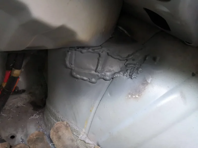

Part of the reason for wanting to get the fuel tank out was so that I could confidently weld around that area. Driver's side rear strut top was rusted out at its corner, as is the spring mount on both sides.
Fixing the strut top meant stripping the trim from the rear of the cabin and the boot, and a lot of patient grinding to uncover the true extent of the rust, which just kept growing. I have limited fabrication tools so the repair had to be made up of lots of small pieces of metal welded in progressively. It's not beautiful but it is structurally sound and that will have to do for now. And no-one is going to notice once it is covered in seam sealer. For now it is covered in a couple of layers of primer while I see to the spring mounts.
In an ideal world I would replace these with some off the shelf repair panels, but I can't find any. So, I'm making up some over-engineered repair pieces. 3mm steel rings to reinforce the rusted parts and a 1mm folded steel brace on the top. These are largely measured up and templated and when I get time I'll get them cut out and welded in. Then the back axle can start to go back in, along with the refurbed brakes etc.

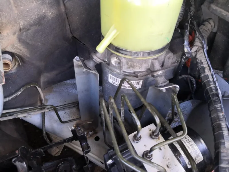

I’ve finally welded in the brackets for the Zafira power steering pump. This was delayed by stuck connectors to the ABS pump – I needed to move some of the brake pipes to access the space where I wanted to weld. I managed to get all but one undone without shredding anything with the liberal application of WD-40 over a few days. This created enough space to grind away the paint with my new finger sander and weld in the three brackets.
In retrospect, I wish I had made them from slightly thicker steel (I think it’s 0.75mm), but with the three of them it should be fine. If needs be, I can brace one of them off the heater mounts (below).

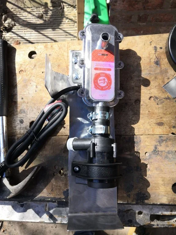

I bought and modified an AC car pre-heater to remove the pump so that it can run on DC. The full 350V of my main pack may be a little much but we shall see. There is now an external 12V DC pump to keep water flowing through it rather faster than I think the internal pump would have managed so that should balance it out.
I fabricated a bracket to hold the heater and pump next to the bulkhead that will be welded to the frame and a former solenoid mount that protrudes from the bulkhead.
I’ll need some sort of filler arrangement. And I need to make up a pipe to take an in-line temperature sensor that I picked up off eBay (irritating 1/8NPT thread that you can’t model in Fusion360). This will connect to an Arduino that will drive a contactor on the live line – a feed from the old A/C connector on the inverter. Plan is to take a simple on/off signal from the wiring from the old solenoid valve that I believe must have routed water from the engine through the heating loop when the heating was turned on in the cabin.

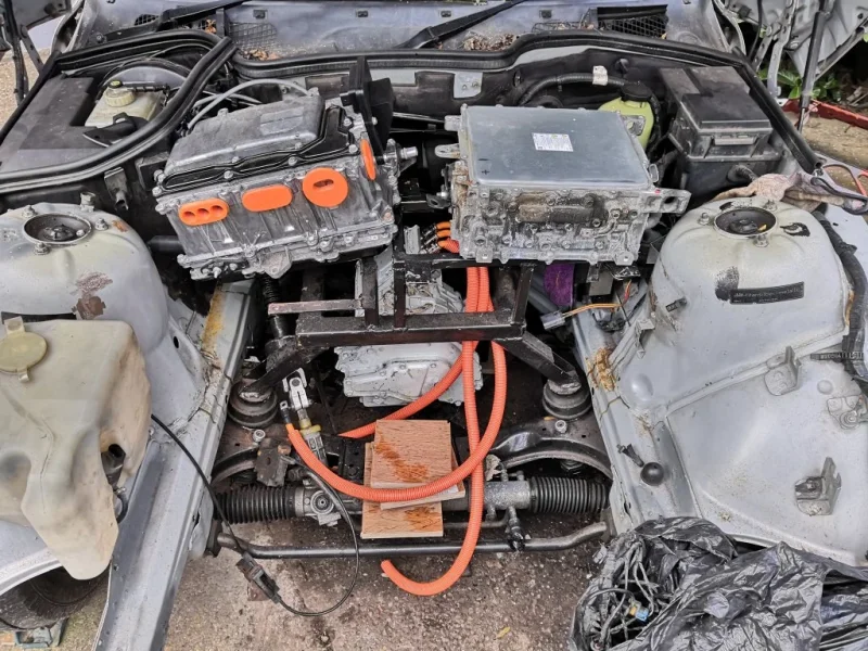

Inverter & charger mounts
I’ve cut off my inverter and charger mounts that were welded to the top of the engine mounts. This is because I wasn’t particularly happy with them after lots of modifications, and because I now have lots more space to play with. The charger is a lot smaller than the old high voltage junction box (replaced by the BMW ‘safety box’ now integrated in to the battery box). Plan is to make up some new mounts with fresh steel so that the inverter can be rotated through 90 degrees. This will create more space for the battery box so that getting the lid on and off isn’t a total PITA.
This should also create some more space for the cooling systems, both oil (for the motor) and water (charger and inverter).

Fix power steering return
My homebrew return line for the power steering fouled the bottom of the battery box. I’ve trimmed the battery box support bar but I still need something a bit lower profile.

Fix my crap repair
One of the first repairs I did on the car was on the inside front of the sill behind the offside front wheel. It’s crap and needs redoing. I don’t think it’s structural but I don’t need to give the testers anything else to complain about.

  • The power steering is not working properly. Pump comes on but there doesn’t seem to be any pressure. Again, could need bleeding more after being empty for so long.
