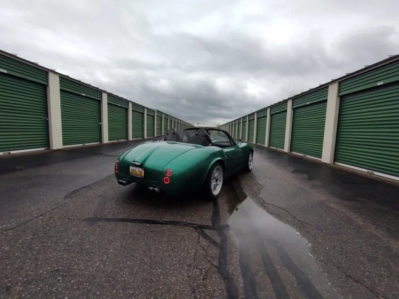

Back at it and some fun stuff.
I was able to fix the headlight pitching issue! The headlight was floating on 3 bolts with springs. I added stacks of washers on the lower 2 bolts with longer bolts and was able to correct the headlights pointing down. Id show pictures but there isn't much to look at.
I went over the body with a coarse compound and then fine compound. I think some scratches are too deep to remove without burning through the clearcoat entirely,so I did my best to just clean it up. I then followed up with a wax (to hopefully fill in some of the scratches) and followed up with a sealer to keep the wax on.
With that done I put it back together. I still have quite a few things to finish/make for it, but it's time to enjoy it a little. I also bought a wind deflector off of Etsy with the car logo etched in! Super excited about that.
Took it to the first car show today and got a pretty nice reception! Then it started raining so I stopped for some glamor pics. More to come!
