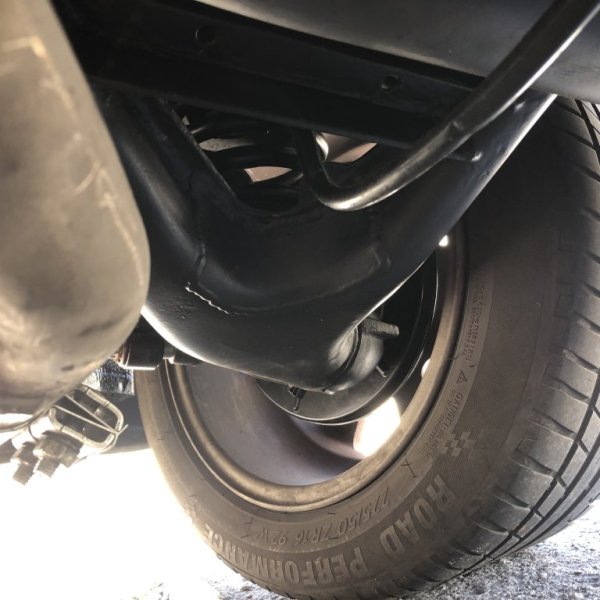

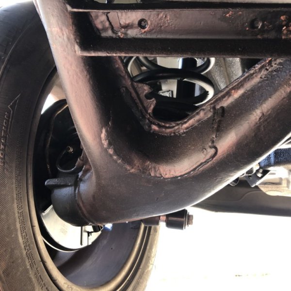

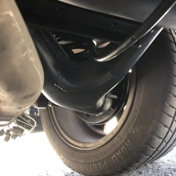

Those arms, I’d want to know exactly how bad they are before splashing out on new. Batter them back with a flap disc, or steel brush in a grinder. BMW arms are 2.35mm thick minimum, so likely formed from 3mm steel. They’re wax filled, so they rust from the outside, they can look really, really bad, but still be useable. Quite easy to reinforce, or reinforce further than standard.
I got a pair of 2.8 arms cheap that were described as probably scrap, I’ve welded quite a few suspension arms over the years, both Z arms were a simple, though time consuming, fix. My time is my own, so I don’t care.
Grind them clean, go over with a small ballpein hammer, find out if there are any ‘soft’ areas. You can also heat it with a blow lamp, OUTSIDE, in case it goes Woomf, any porous areas will ‘sweat’ from the wax inside. If the damage isn’t significant, cut out and replace the soft area(s). Reinforce to death. Sorted.

Very successful day, the subframe is now solid and part of the car. Took a good 6 hours and 6 bottles of Gas to fix it all. Combination of 1.5mm plate and plenty of weld and she’s golden :D
Just need to do some tidying up, primer and paint it all.
Dan was having a nightmare between the thickness of the metal and just blowing holes in the floor. Said it was very difficult.
Some plate to make it all more solid, and other spot welds plug welded
Showing the raw welds. Rough but strong.
