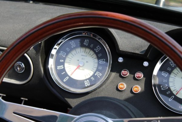

After many days of deliberation, studying endless wiring diagrams (which I don't fully understand TBH) and talking to several people, I have decided to keep my BMW instrument cluster PCB.
It is sooooo complicated that I fear bypassing it will remove something that is important (like the DSC).
So I have just soldered extension cabling to the four warning bulbs I require on he dash. These are front and rear fogs, DSC and the ABS warning lights.
The other lamps required are dealt with by the new gauges, so I am happy to cut those from the loom and join them to the new locations.
I wish I'd done this, but my original intention was to eliminate the cluster completely. I used brighter bulbs than standard, so I'd have used the wires shown as signal wires, and used transistors to illuminate the bulbs. I doubt if you will have any problems, but my dash bulbs are 2W compared to 0.5W in the cluster - I know that you are using 0.5W bulbs :) .
All the black dash bulbs seem to be 1.2 watt with the two odometer ones being 1.5 watt.
All the bulbs I am 'extending' to are tiny (6mm) LEDs that I don't know the wattage of, but they are something like 0.1 watt.
I have removed all the original bulbs that I don't need (which is most of them TBH), as I am a little concerned about heat build up when I 'insulate' the PCB.

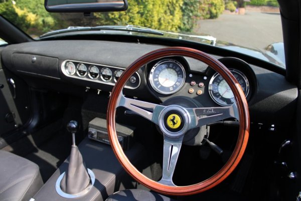

I have also had several conversation regarding finishing the new dashboard. My upholsterer was not confident he could make it look decent if covering with leather or vinyl, so after much thought, talk and research I have decided to paint it myself with this stuff.
The red is for the engine covers later.
The red is for the engine covers later. View attachment 335897
You're painting the dash fabric with VHT paint?
Two things that I noticed on that blue car at the Nottingham show...
The petrol flap was the same as yours. A very clever design that can only be opened when the driver's door is opened.
His dash and cam covers were sprayed with that wrinkle paint. He told me that there is an art to getting it right. IIRC, sray once along the length of the dash from left-to-right, then spray at 45 degrees from bottom-left-to-top-right, then at 45 degrees from top-left-to-bottom-right, then use a hair dryer to create the wrinkles. You need enough heat to create the wrinkles, but not so much that the paint blisters. It took him several attempts, but the end result was quite good.
His rocker covers were very good. He even managed to add the name and four stripes to the cover by using moulded letters and body filler. Sounds really bodged, but the results were impressive.
The new dash is GRP and is not going to be covered now. Only painted with the wrinkle stuff.
The 250 cali dash is a pig to cover nicely, so I am giving up and painting it.
The petrol flap has been 'redesigned' by my bodyshop to fit properly with the return edge hidden by the driver's door. That was the original DNA way but because I bought my expensive kit from our friend @jaguartvr, he cut corners (with everything) so it was crap and had no return on it, which meant it was almost impossible to sit properly. It was also extremely flimsy and didn't fit.
Not that I am bitter, of course. ;)
I have watched videos on how to apply it and spoken to @Jezza who has used it previously. I shall be starting to practice with it tomorrow. I am going to try a heat gun and a hair dryer, along with etch primer and no primer to see the differences. I have bought a shed-load of the stuff.
