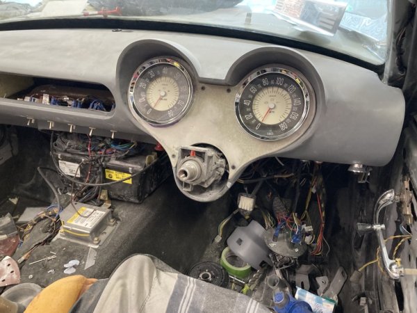

I am not sure if you noticed but a few of us have made a separate surround for the Speedo / tachometer which allows you to remove the clocks and warning lights without removing the whole dash it also gives you a bit of access to behind the dash, I must admit I have had to remove the whole dash several times and its no fun to do. I have used the removable clock section several time chasing electrical gremlins and rattles and it makes it a lot easier.
Also I if you are using the push / Pull cables to control the heater you can cut a small rectangular removable panel around the pull push controls this means you can remove the dash without having to disconnect the three control cables.
I have been mostly pre-wiring my new dash in the last couple of days! :)
I needed to test my wiring, so I tested the pretty gauge lights first (as they are interesting).
I had a small problem with one bulb holder, but it was quite simple to 'adjust'.

I agree it is, however, I will leave mine as is and have to struggle as I can't bear the thought of 'panels' in the dash.
I have hopefully made it as easy as possible to remove the entire dash if and when needed. It's the heating 'cables' that are the only major headache TBH (I hope).
I have been trying to think of a way to 'join' the cables just inside the dash to release them if needed. I haven't found anything reliable enough yet.
One thing I have noticed whilst checking my instrument wiring is that ANY feed to the speedo (even just the illumination feed) lights up the odometer figures. It isn't just the backlight on the LCD screen, the numbers power up in black aswell. Doesn't seem right to me. I shall be asking John at ETB at some stage.
Your dash lights seem very bright. Perhaps they are so bright the light is being bounced all over the inside of the instrument.
Perhaps try using a variable resistor to change the brilliance, then either use a variable resistor or use a fixed resistor of the required value.
My dashboard lights are not as bright as yours...
View: https://youtu.be/N06kk5qxFNk?si=LBro7WnVjnpENDrJ&t=380
They're not. It's just the way the phone picked them up on the camera. They are standard ETB (VDO) gauges with standard bulbs. The resistor coil in the Z3 light switch dimmer will adjust them anyway. I am lucky to have one that hasn't crumbled to pieces. ;)
