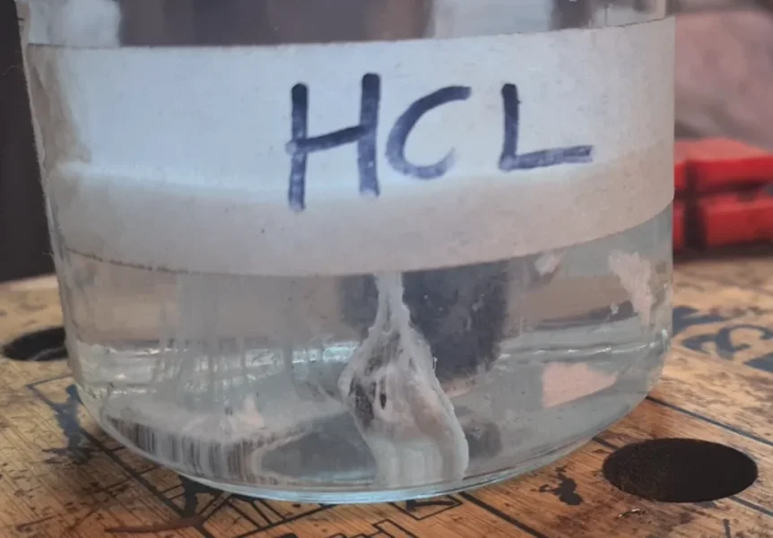

Yesterday I thought I'd change tack and have a go at DIY zinc plating...I've tried before with various degrees of lack of success..so thought I'd try again.... caveat, this is NOT a zinc plating kit... more of a witches home brew... =))
The plating solution is 1 litre of distilled vinegar and 100g of Epsom salts.. the zinc plates are left in overnight to create a "pickle" solution...
the power supply is an old charger, with the positive and negative leads split and crocodile clips attached
Then I setup my plating station...
Hydrochloric Acid (HCL) which is 36% concentration, this is to strip old coatings and contamination,
De-Ionised water, acts as a neutraliser between the stages... the Zinc solution is in the bigger tub and then the passivate is to harden the zinc layer.
caliper bolt was cleaned to within an inch of it's life
It was then put into the acid until the fizzing stopped...
After dowsing with de-ionised water, it was then into the plating bath for 20 minutes
This is the bolt after 20 minutes, with a good zinc plating
After rinsing with de-ionised water and dipped in yellow passivate for 20 seconds..
And that's where the success ended.... within 15 minutes, the parts had started to flash rust....I'd clearly gotten something very wrong...
There are two schools of thought.... one is.... after the HCL bath, you're supposed dry the part completely to stop the acid stripping process, the other school of thought is, you submerge in de-ionised water straight after the acid to stop the acid process.... I went the straight into de-ionised water to halt the acid... which clearly hasn't worked.....
I'd be interested to hear from anyone that's done DIY zinc plating and whether you used a bought kit, or DIY witches brew !! :whistle:

Ok so another go at plating !...… tried a stronger power supply which was a 500mA charger... using a Centre Positive charger jack... used a rivet as a Positive connection and the connector shell as a Negative.... nothing sketchy about this at all =)) (this is only because I'm trying various chargers, and don't want to cut the connectors off them all)
but it gave a good fizz
The difference from the other day, is that I dried the parts with a heat after each stage, so acid dip in Hydrochloric Acid (HCL), then washed in de-ionised water, then DRIED COMPLETELY with a Heat gun. Only then did I place it in the zinc tank, and let it coat for 10 minutes. After that it was rinsed again in de-ionised water and then DRIED COMPLETELY with a Heat Gun
The other major difference from my failed attempts was to NOT leave them in the garage in a potentially moist atmosphere. So they are currently "resting" next to my PC monitors... I'll leave them t harden for 24 hours, and if there's no new corrosion, I'll buff them up using a polishing pad
