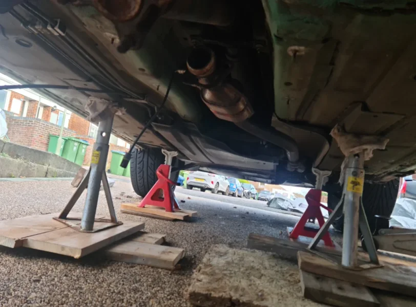

So today I decided to brave jacking the car up enough to get all four wheels off the ground.... on a slope and on a resin driveway (very expensive !!).... To say I was initially cr@pping myself is an understatement. I thought I'd try with a big lump of wood and jack under across the prop shaft tunnel but it just didn't feel right, so abandoned that idea... then I decided to heed the advice of @DrWong , @IainP and @Althulas and gently, little by little do each corner. The rear end looks really high, firstly because it is to counteract the slope.
Initially I used a long block of wood on the chassis rails, which lifted the whole offside.
Then I lifted the rear jackstand up a notch and gently slid the red jack under the chassis rail.
then had to add "shims" of wood planking under the rear jackstand to take up the slack. I didn't want to have three jackstand holes exposed as that felt too unstable, so I'd rather lift the jackstand higher than make it taller !
you have probably see at the back the angle of the slope. Then repeated on the offside... doing it literally inch by inch, adjusting the wood and adjusting the stands as I went... eventually got it so that I can just move the front tyres... they'll be staying on until I need each one off in turn.

That is a bit of a slope, I didn’t realise it had that much incline. To be honest seeing that pic I would consider just have the back jacked up and the front wheels firmly on terra firms and finish the rear end, then work as far forwards as you can with the ? Fuel lines I can see on the floor. Then have you car firmly on it rear wheels and chocked etc and then work at the front. It would be a lot more safer and probably save you having to wear bicycle clips. Stay safe.
haha... thank you mate...I'm not taking the fronts off until the last minute...they just touch the ground..what I might do is fix the sills then get the rear on the rear jack pads...that's just the vent pipe, fuel lines are still clipped in and need to be replaced along with all the brake lines...now I know I can do it, I might put the rear onto the jackpads until I need the space to weld up...cheers mate
Good work mate. Always a bit unnerving getting the whole car in the air. Probably a sensible idea to chock the front wheels anyway, accepting that they're not quite touching the ground etc.

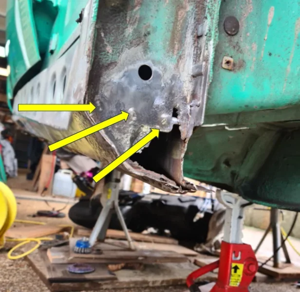

I decided to get the front wheel off and that's where my luck ran out.... pushed the grommet and my finger went through. Decided to grind back to good metal..
I'm wondering now what the options are.... do I chop out and let in a new piece? or weld a patch over the top?A pro would chop out and let in I guess....So I get to learn fabrication earlier than I planned @IainP !! :whistle:
I thought the inside had gone as well, but after grinding back it was crusty rust and lifted seam sealer....
actually.... have I struck lucky?.... just noticed three rivets and above that is good clean steel.... maybe I can weld a patch in where that sheet meets the rusted part, below the dotted line

I would cut it all tha section out and make a plate with a step that goes behind the spot welds. You spot weld at the drill out spot welds and butt/seam weld across and the outside of the plate.
aaah.. I like this..proper fabrication! cheers mate
If you watch Yorkshire arresorations on YouTube you can get some ideas that can be achieved with there approach to patch panel making but as I said before you have to be brutal and cut the crap stuff out no point in plating over rusty stuff, it’s shoddy and will come back to haunt you if you keeping your car.

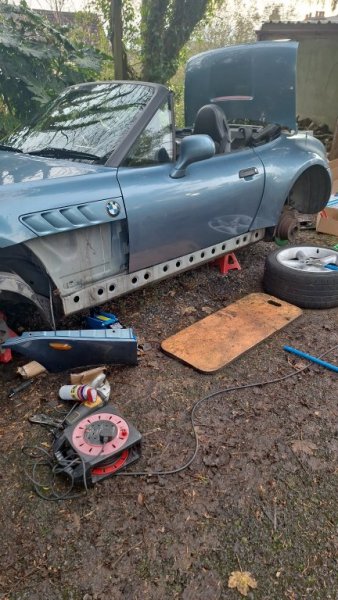

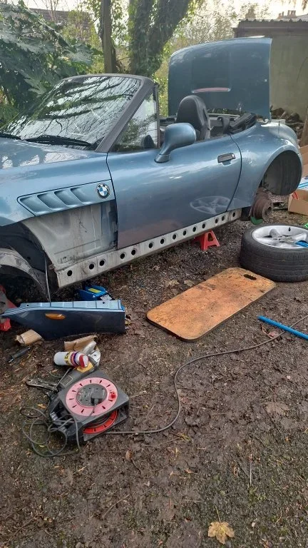

You want to cut it above this faint red line
Just above the square hole.
First though, to make a pattern use several layers of masking tape. That will peel off in the shape of the metal you need to make. Snip the corners and spread it out, now you have the corner angles you need to cut to allow it to fold neatly.
Bottom fold first, then the sides. Trial fit, it won’t go into place, since you haven’t cut yet.
Mark or centre punch a dot vertically above the square hole, 50mm or whatever convenient, mark the distance.
Now you can cut out.
Cut exact if you want to butt weld.
Cut 5mm lower if you want to tuck behind it, either riveting in place before welding, or plug/rosette welding.
I’d cut a chunk of that sill off, 60-100mm, and remake it, you can hammer form that channel over some pieces of wood. Sound much more daunting than it actually is.
Oh and remake the square hole, drill and file from your measurement.
