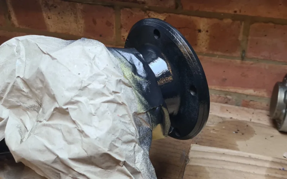

So.... onto other things... tidied up the Hub and decided to use my current favourite black stone chip
yes it looks grey but it's just the light reflection..

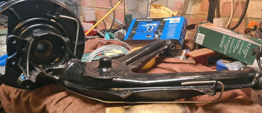

well today I thought I'd push on with the Trailing Arms... put the dust shield on the other Arm as before and of course had to patch up the paintwork from the inevitable scratches. So... while that was drying I thought I'd start on the Trailing Arm brake pipes..
I looked back at photos of when I took the subframe off and tried to copy to routing, so did this...
and it just didn't look right.... so looked back on here to see other people's routing and then did some digging on the interwebs.... and it was clear the back lines had been replaced at some point and wasn't OEM routing !
So I started the fettling, this time having a go at my pipe bender which I managed to use properly this time.... and fashioned this
massaged it a little more by hand when in situ.... when was happy I trimmed the ends off with the pipe cutter, and then put the unions on and flared the ends.
yes it all needs to be clipped in that will pull it into the trailing arm, it's just swinging in the breeze at the mo
