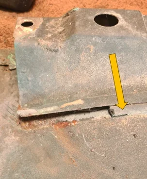

bit a bit more Time Team and dug away at what was causing all the rust on the inside.... turns out the stiffening U channel is "sealed" with some body seam sealer. So the any water just sits on this and rots through....I picked some of it out with a screwdriver and it was all surface rust underneath which bled through to the outside paintwork
I used a finger sander, dremel wheels and even a milling bit to get into all the nook and crannies
You can see the holes made my standing water as it can't drain out
More seam sealer picking out... rinse and repeat on the other wing.... and the same symptoms... rusted along this stiffener... I've arrowed what left of the sealer which didn't have rust behind it

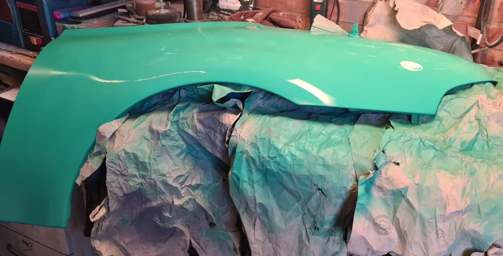

well today was laying down some paint day......... all went surprisingly well..... and then.... I had to have a visit to the confessional.... :whistle:
let me explain..... so
started with wiping down the panel... ready for paint...... that little dark area arrowed in yellow becomes important later........
anyway... let's get some colour down
started off with two coats of fiji green and I must say I am really impressed with Tristar colour paint.... went down SO evenly
and this is how it dried......very impressed
I then did the other wing but it was very clear that what I thought was flat... was very clearly not.... so although the paint finish was fantastic... that's going to have to come off and be resanded
next up was the offside rear quarter and I have to say the colour match is excellent !!!
I actually finished just below the filler cap, even in person once the paint had flashed off you can't see the join

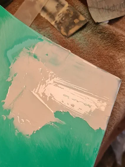

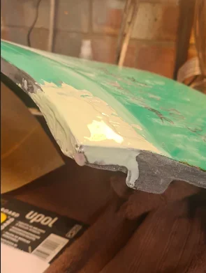

I haven't posted much progress because it would be me.... painting panels... not being happy with them, finding lumps and blemishes, rubbing it all down again and redoing it all...... three times..... GROUNDHOG DAY !!!........BUT...... we're getting there...and this time I've gone for it. Rattle canned the whole lot, and it looks a lot cleaner..........
The offside wing had a wavy ripple from the dolphin glaze, I could see in daylight ... so that all came off and redone and re primed...
while that was drying, I went for it on the nearside rear quarter, fully rattle canned....
it will dry dull while it gasses off ( as you can see on the left hand side) but 2 coats of 2K clear coat will make it pop....
Then it was back to the front wings, now fully done with two coats...you can see the dull paint that's already gassed off.
I REALLY didn't want to do the Offside rear quarter again because I'd gotten the paint just right.... but... a little lump near the bottom was really bugging me....so off it came again......
stopping filler applied
Then got it so it was mirror smooth...... combination of 60 grit pad, 80 grit pad, 1500 grit dry, then 1500 grit wet....
then on with the first layer of filler primer, I'll leave that to fully go off until tomorrow..
