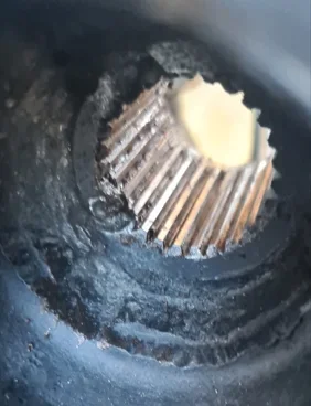

right..... *rubs hands*...... driveshafts....
Started off with brake cleaner and a small screwdriver to clean the grooves out.... then a liberal coating of copper grease
Those of you that remember the nightmare of me trying to get the driveshafts out 2 years ago !..... well it was time to revisit my nemesis.
The damage is the result of me heating, hammering with a punch; hammering with a cold chisel; punching it; kicking it; swearing at it...doing everything to get the nut off as I had rounded it off... eventually I managed to drill it into several bits with a Dremel carbide bit.
You may think that's too far gone and I should just by a new hub......... but... oh no... this won't defeat me...

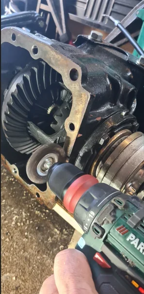

knocked the high spots off with a Dremel rough drum
that took care of the proud bits of "mushrooming" metal... now for the grooves

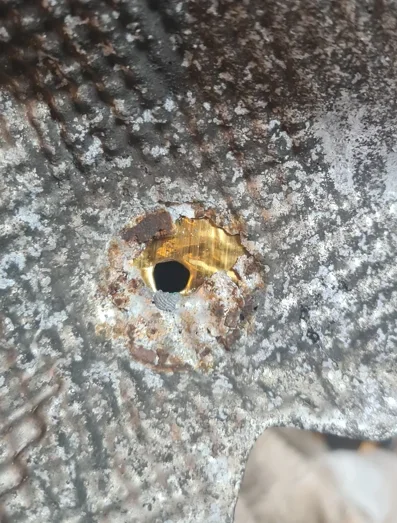

for this I used a carbide bit on the Dremel, to drill out the grooves..
started out like a WWI crater in the Somme
but with the Dremel bit... I ended up forming new grooves

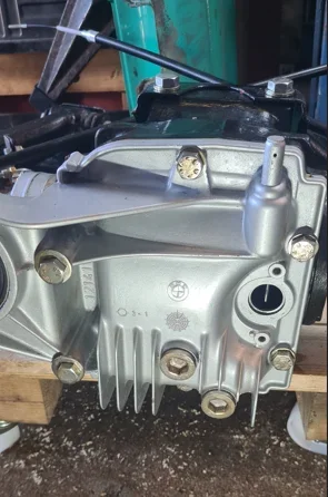

and to my eternal relief.... they're both in !!!.... nuts are only there so as not to lose them... yes I have the anti rattle washers so will put those on an torque up another day
but here we are ... all back together with zinc plated bolts and brackets
